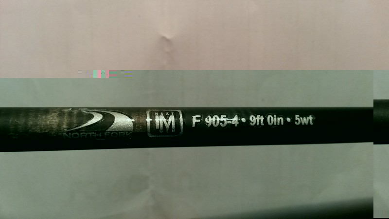

Ensuite, voici les conseils supplémentaire de NFC :
L'étape 3 est vraiment très importante car sinon t'auras un vernis bosselerNFC a écrit : 1. Make sure your surface is clean prior to decal application
2. Use burnishing tool to carefully apply even pressure over transferred decal ink (edges are NOT lifted)
3. After removing transparent backing from decal, use a CLEAN cotton cloth to GENTLY rub over decal area to remove residual transfer adhesive around edges of decal letters (BE GENTLE!!!)
4. Check for smooth decal surface by GENTLY running your CLEAN finger over decal
5. If you feel rough edges or debris, repeat step 3 & 4…
Tu verras, le résultat est vraiment top !!!
Bon courage !
